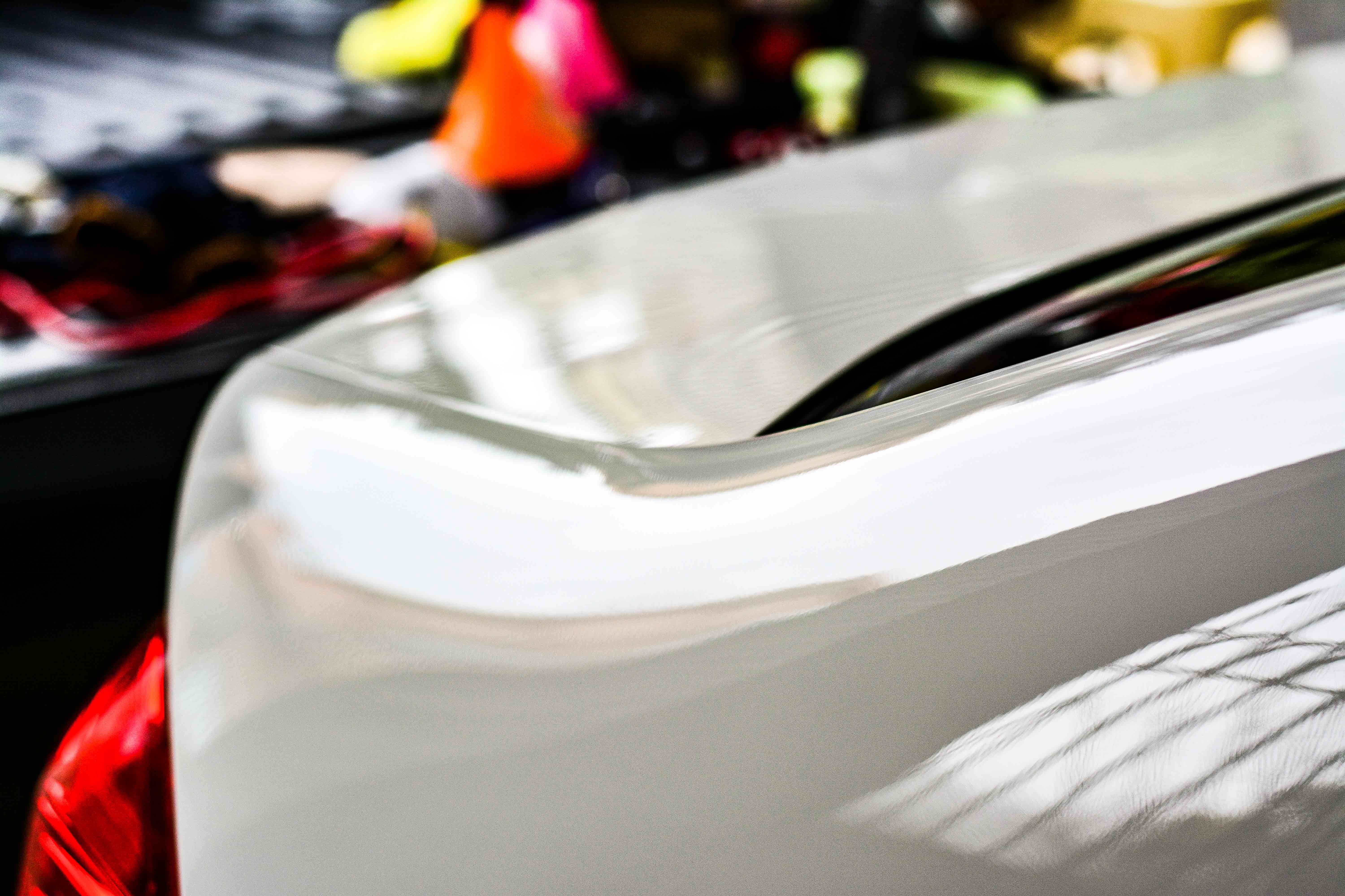

Done 22000 kms yesterday
-wash ( honey dew followed with gold class)- wheel wells coated (reflex)- decontaminated (car pro iron.x and tar.x)- clayed (clay mitt)(clay lube)- DA compounded (sonax)- DA polished (ultrafina)- DA primed ( car pro essense)- 5 layers of cquartz uk 3.0- 2 layers of cquarts gliss - 2 layers of reload cquartz- nanoskin glass sealant
Great work and you have got some great collection of detailing products as well.
