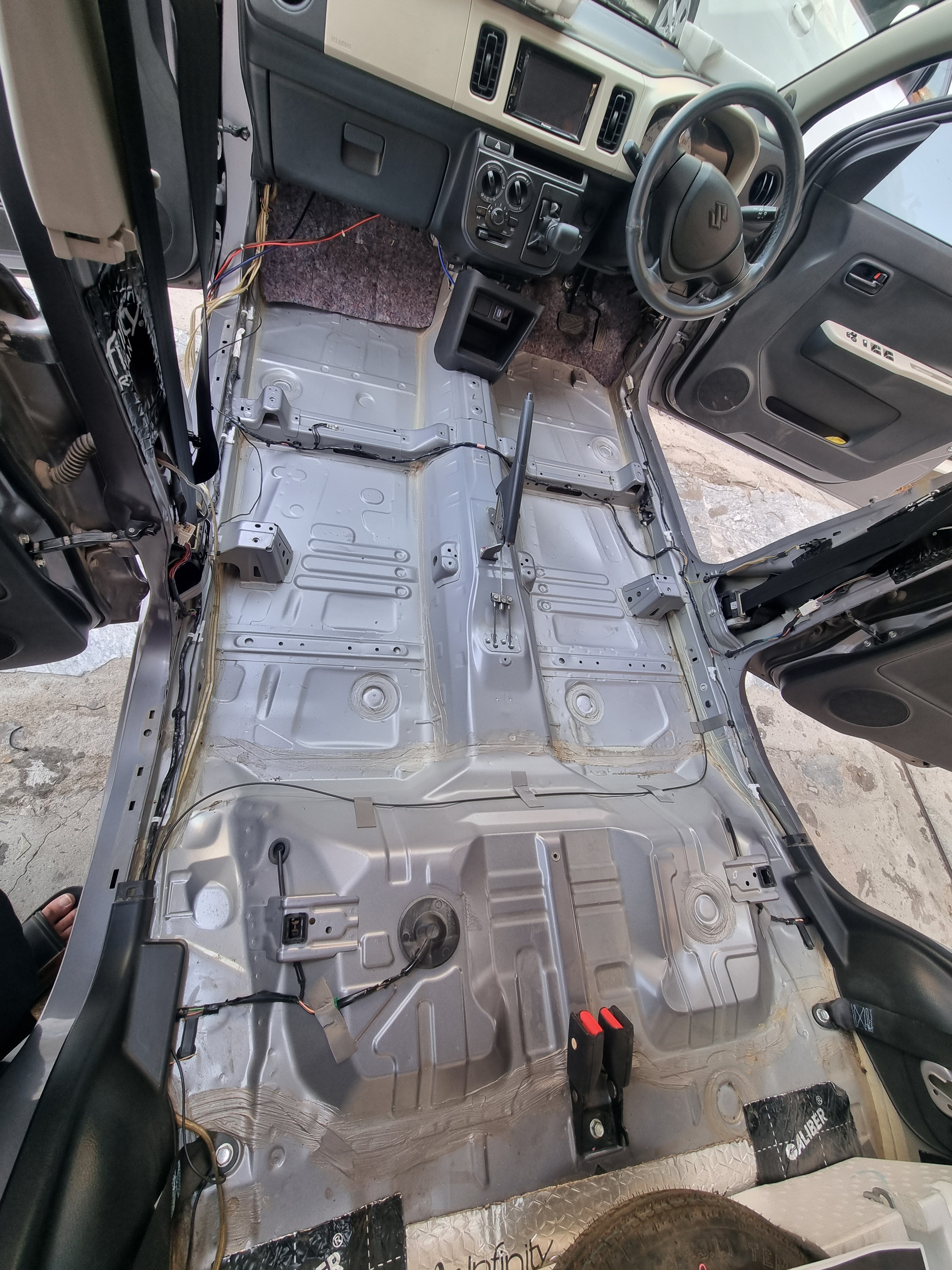

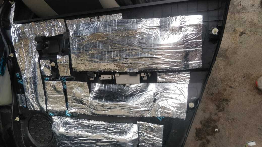

Sound deadening has only taken up speed now amongst shops but only a handful of people started doing this since quite a while back. Most of those individuals are pakwheelers but almost all of them have left the forums because it isn't what it used to be. Regardless, almost every shopkeeper will tell you that by just installing the deadener, your car will transform into a RR. What BS. It takes much more than just a deadener to achieve a few -dBs. But atleast it does eliminate the metal resonance which is absolutely terrible in cars like this Alto
