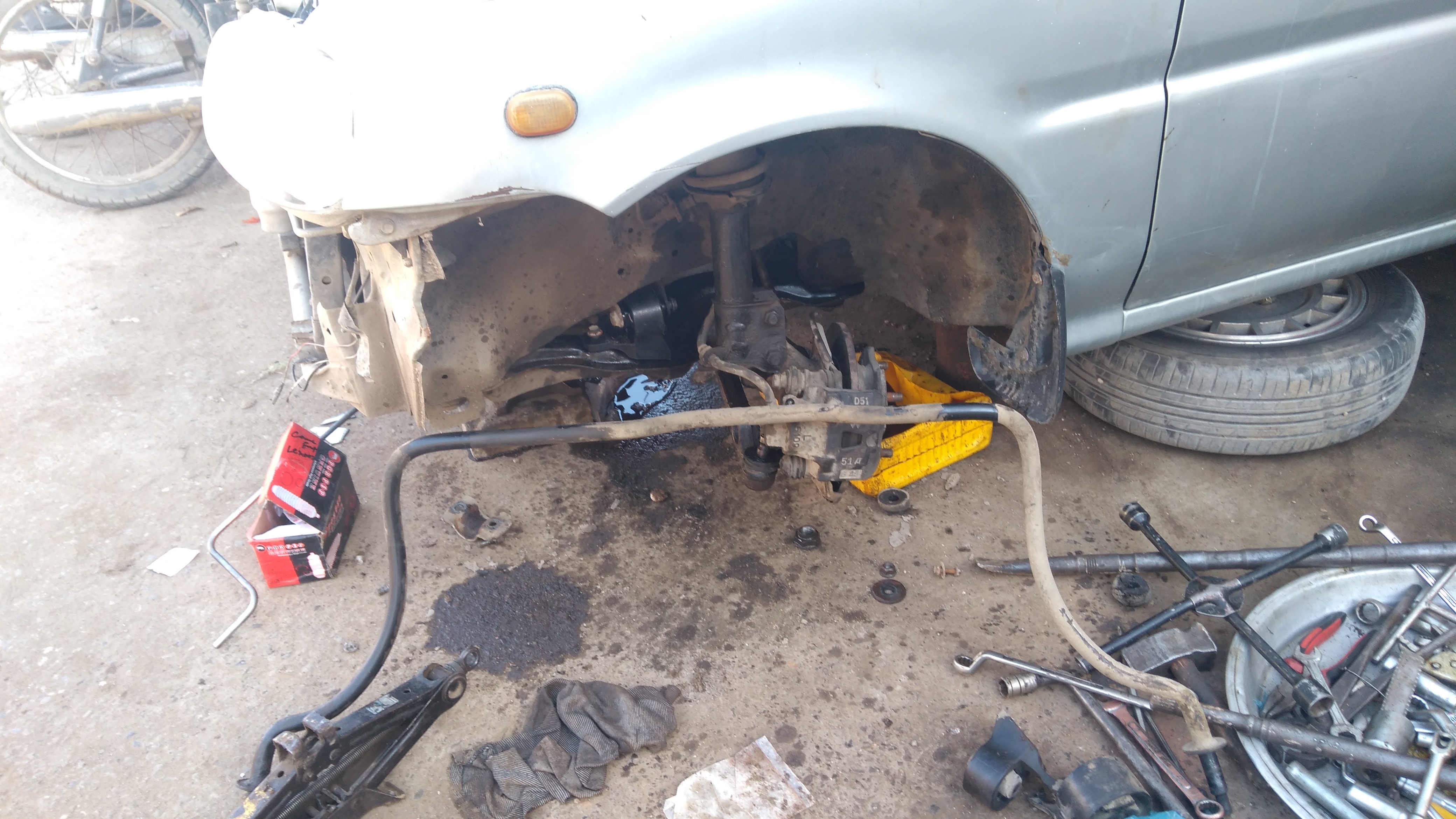

I woke up early today with cash in pocket to get stuff done. I surveyed a few shops around the square and found out that most shops had terrible parts. Although, I did find MK brake pads/shoes being sold as "Japani' pads. In an hour, the mechanic came and took the car to a test drive. Truly, the skidding was present.
BRAKING
1) He made me notice that upon braking, the car was skidding to the right side. It was.
2) The wheels were apparently so off axis that they were not making contact with road much.
3) I had been noticing the off axis wheels since I bought the car, but never thought they could have such an impact on braking.
4) I went to the best shop in the area. Waited for 2 hours. Got wheels alligned. For rs. 250.
5) I took the car on a free road, accelerated to 60, then pushed the brakes hard. The car's braking was immensely better, I'd say upto 30%. The car's skidding was also drastically reduced by up to 70%.
6) The car's CV joints are in bad shapes and need work. WIll get this done too.
Problem has been largely solved. But this does not mean I will not get the brakes done. Soon, I will.
