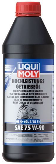

Thank you for the reply much appreciated
Had the front cv boots redone so had the axle out and noticed the axle seal have signs of a leak starting
So replaced the seal
Lost about 100ml in the process only have to fill that amount up so was waiting for the same oil as factory filled
The oil that was lost was still golden and didnāt smell bad
Itās done 80k km
The transfer case oil is on order too 16K Rs per litre from Dewan from Germany
