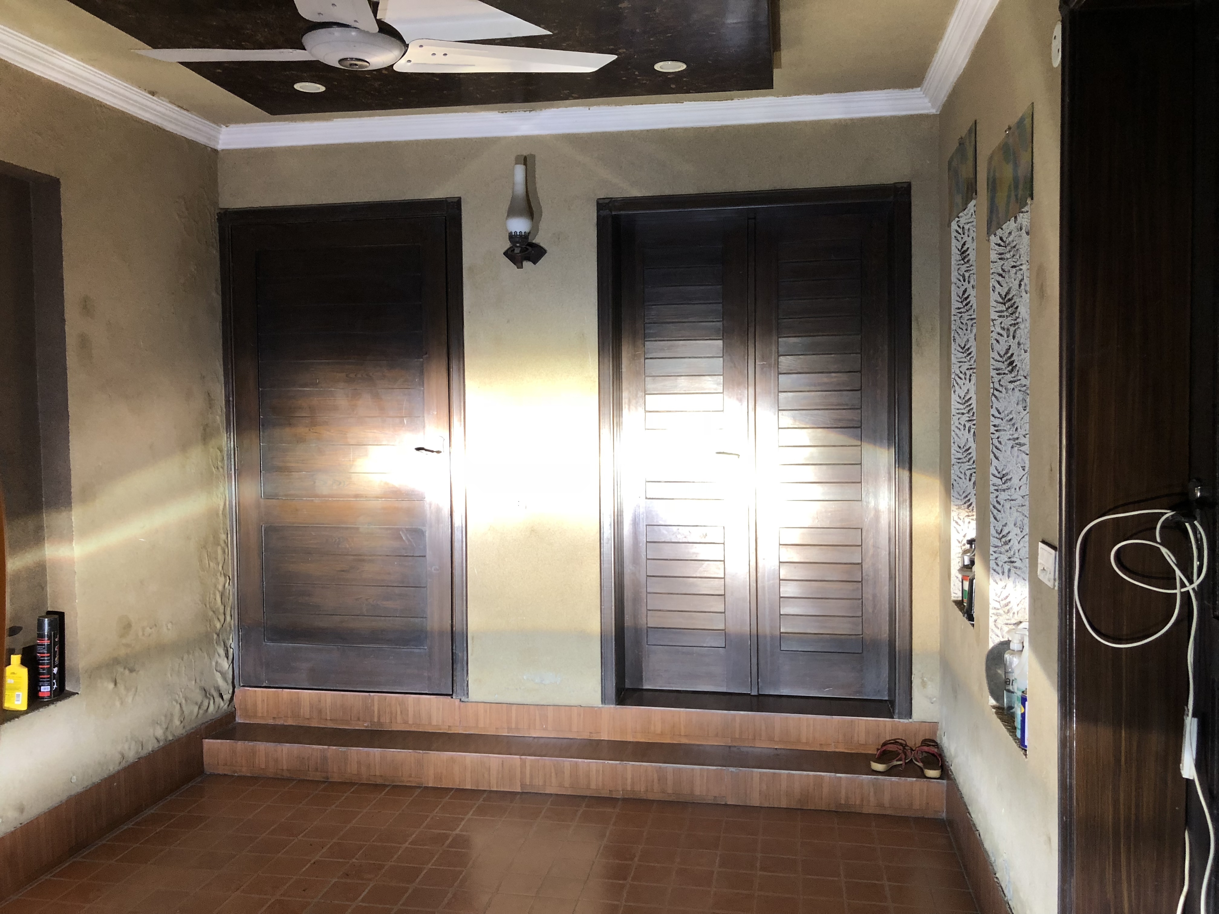

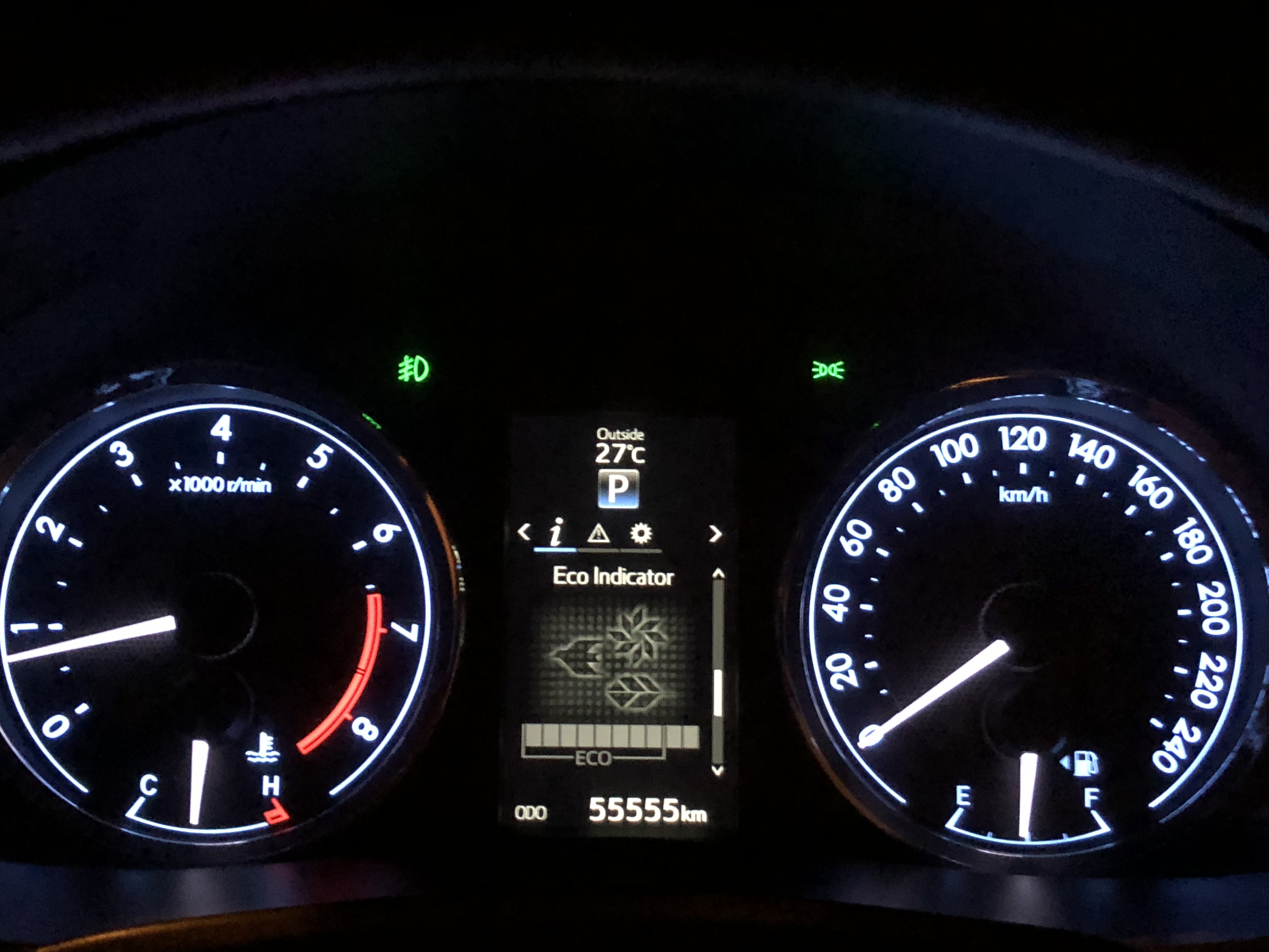

Results are here
First one is all high on
