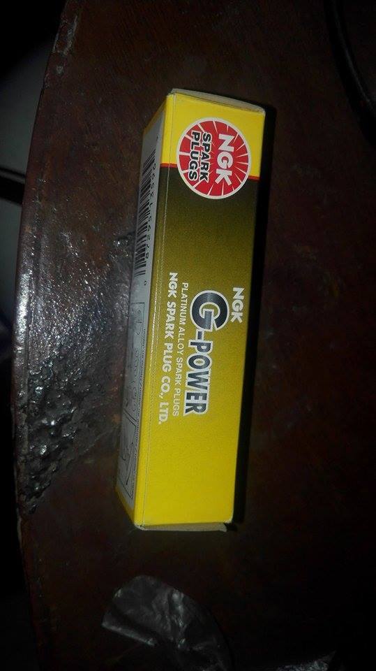

i was feeling from last few days that bike is not running smoothly. so went to my machanic and asked him to check tappets .(last time tappets adjusted 24000 km back) he told that tappets are ok . just change the oil . i told i have changed it just 300) kms back. he told might be i have poured some fake oil but i was sure that i have been buying from same petrol pump since last 3 years. anyway i tried hit and trial method and first washed the air filter. bike felt a little bit better. after that discussed with @tucknologi (Mansoor bhai) he told me to change the spark plug (which is still stock ) so i got a NGK platinium tip plug. now bike is feeling much better . i will check performance on some empty road and then will change the oil if needed.
Same plug for 30k+ km, means asking for trouble.
I used to change every 10k km on my GS.
