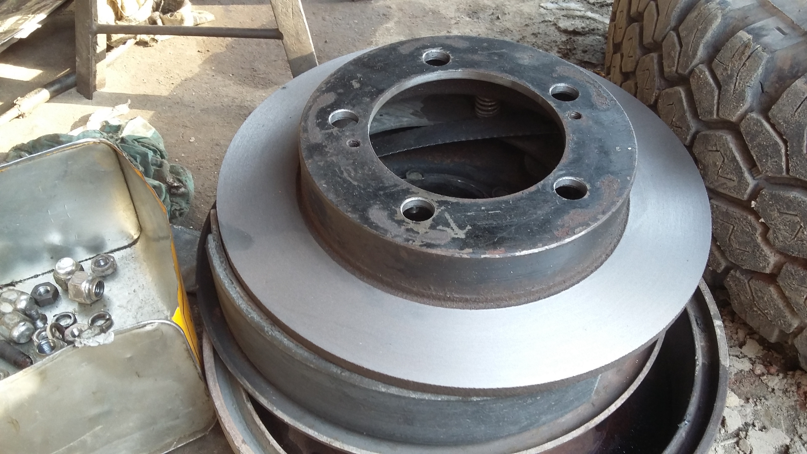

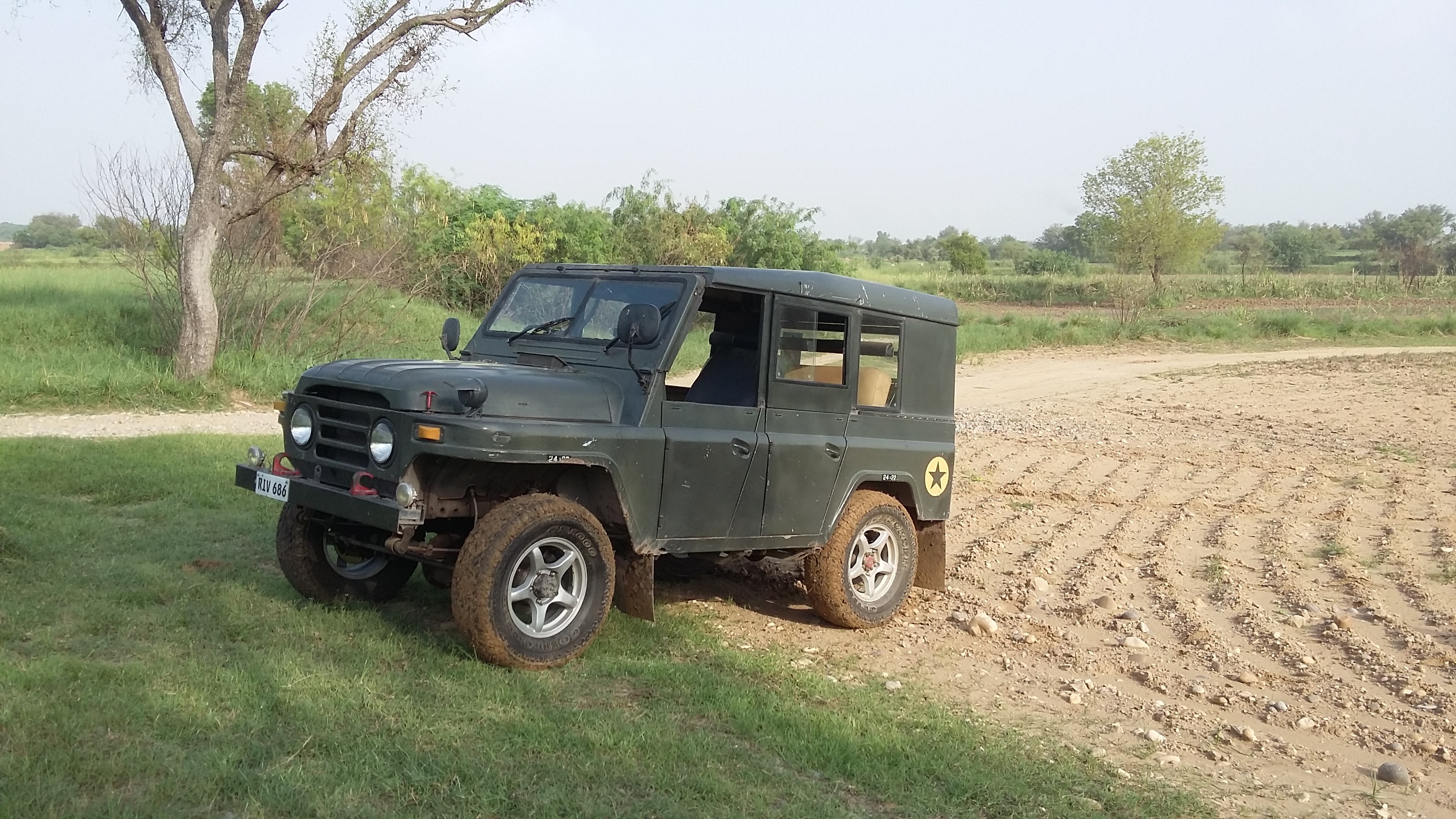

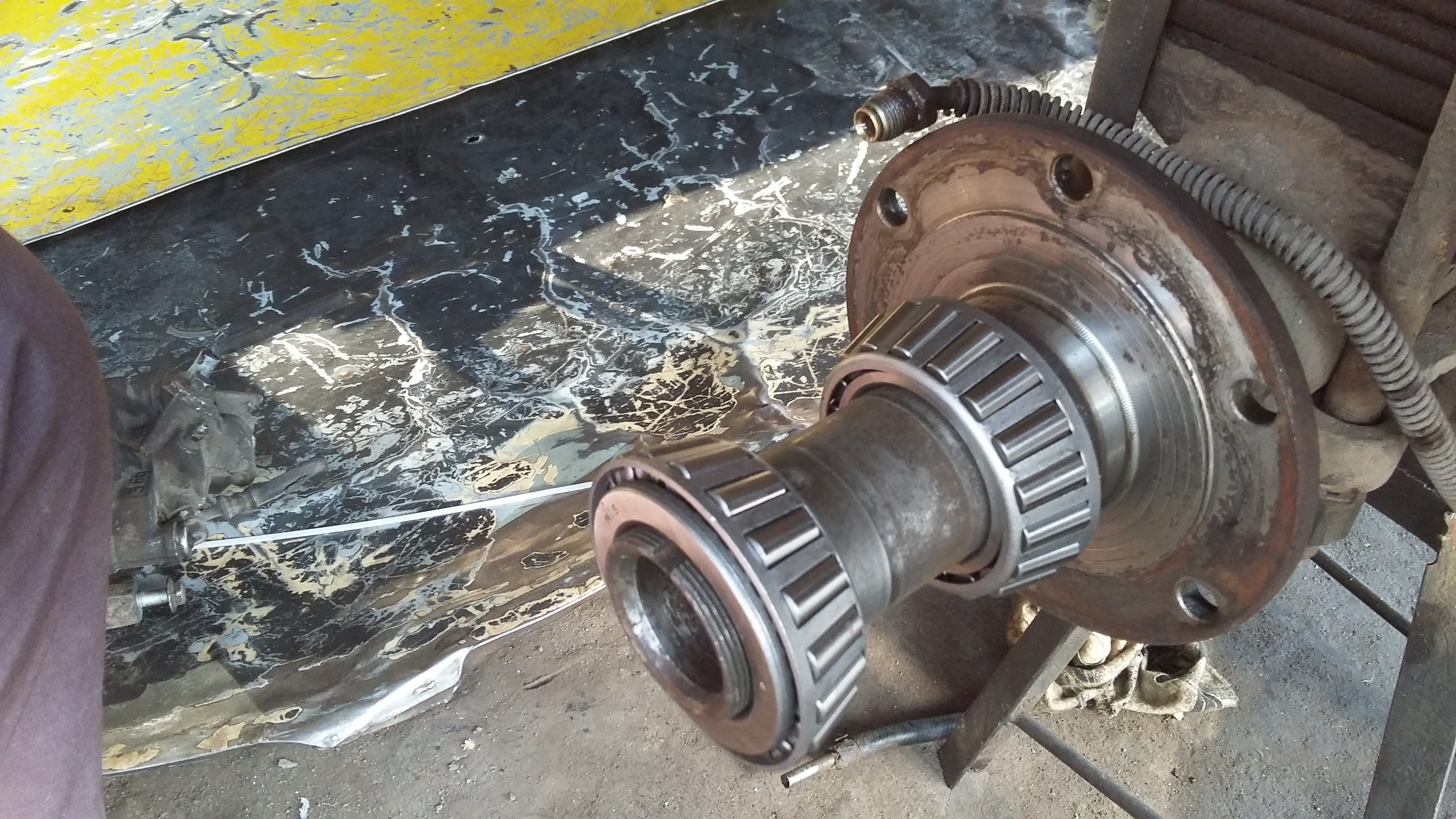

Going for all 4 wheel discs. I am planning to have two different levers for both the rear wheels. Details/ reasons once i install them.
full floating tubes ,,,,,,,,,,,,,,,,,,, ahhhhhhhhhhhhhhhhhhhhhhhhh

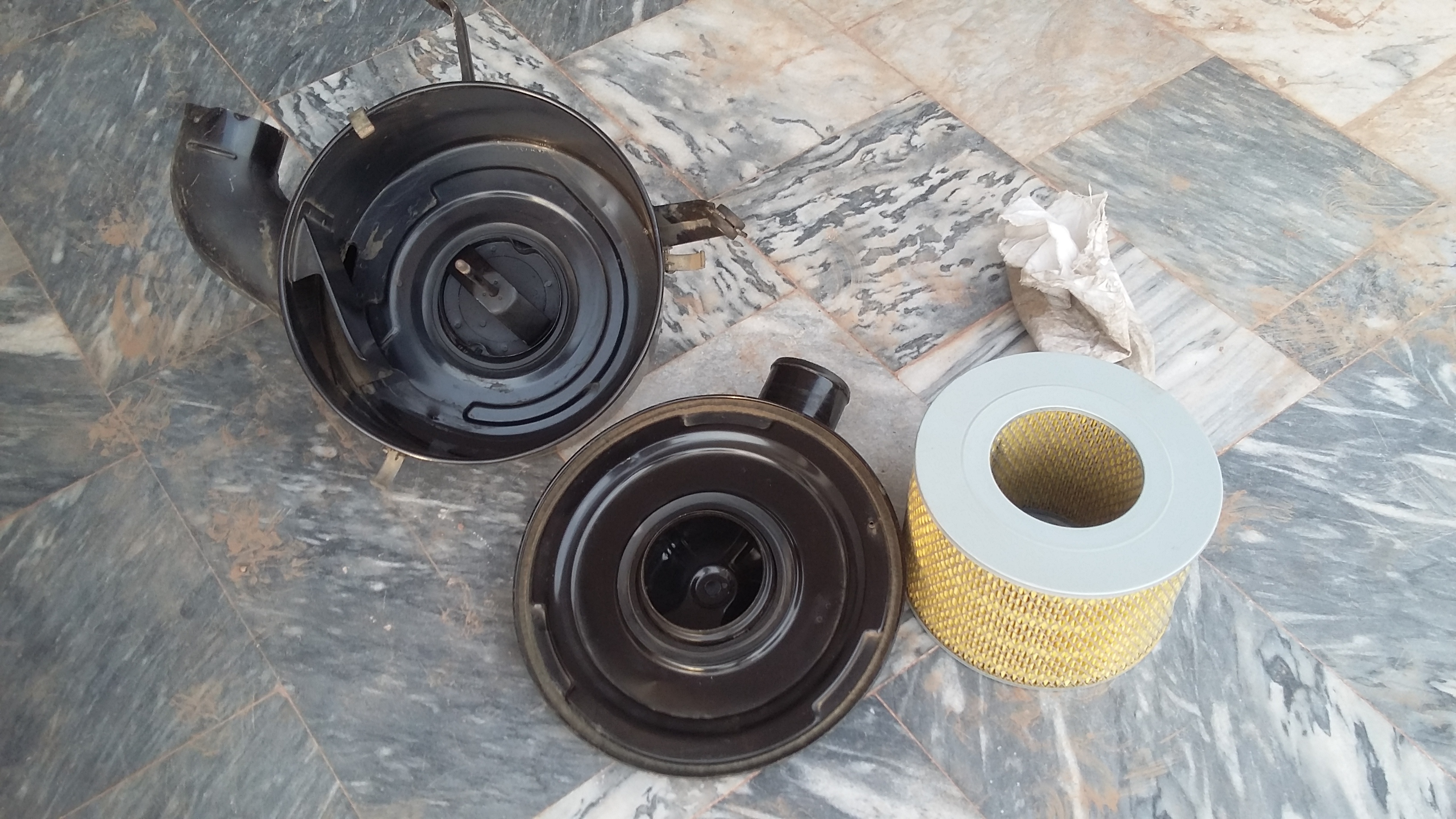

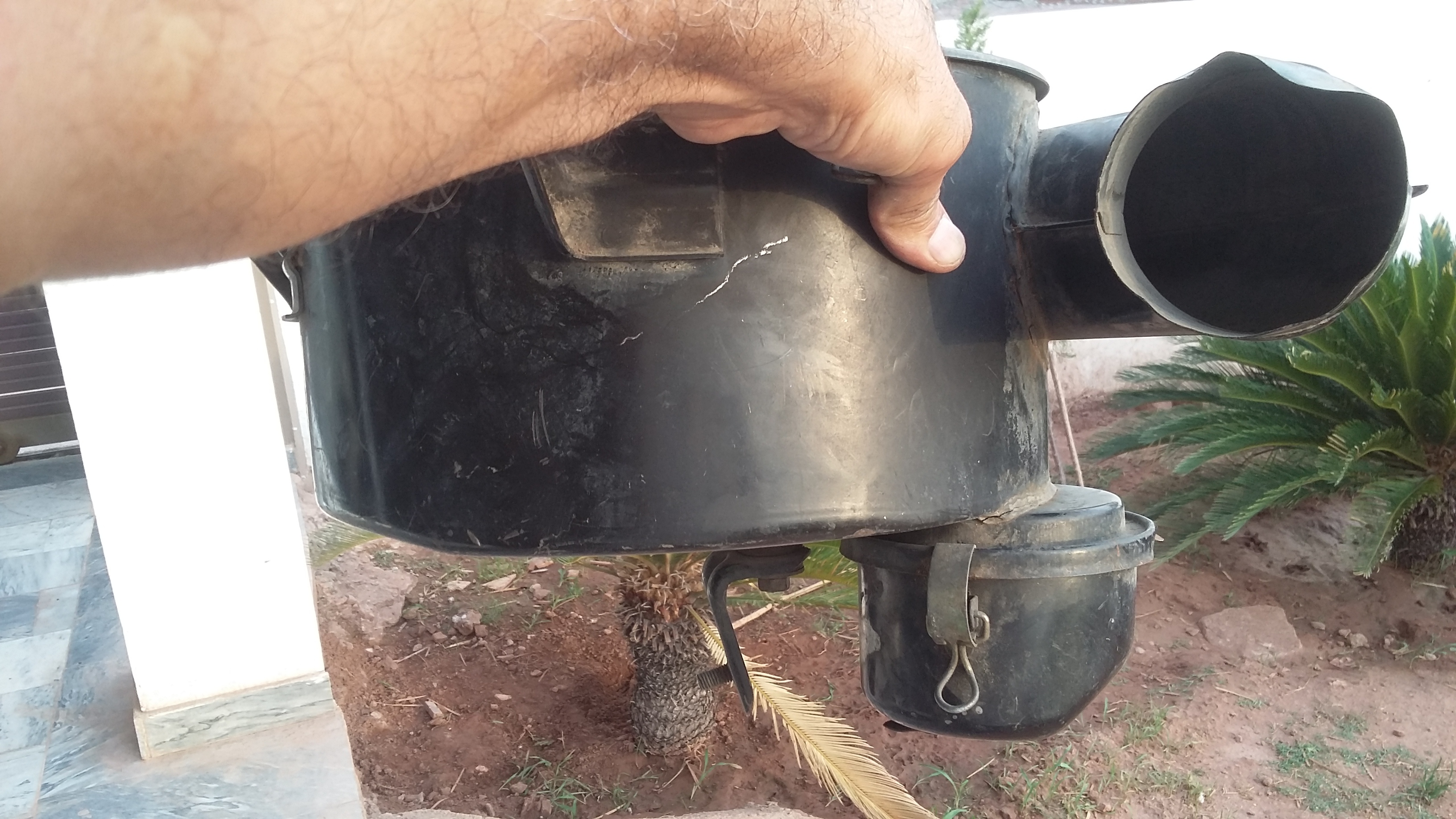

Initially, during the engine change, we got this oil set up for the air intake. Which basically was a little small for the engine. So get this one from an original B3 kabli vehicle. Old vs new.

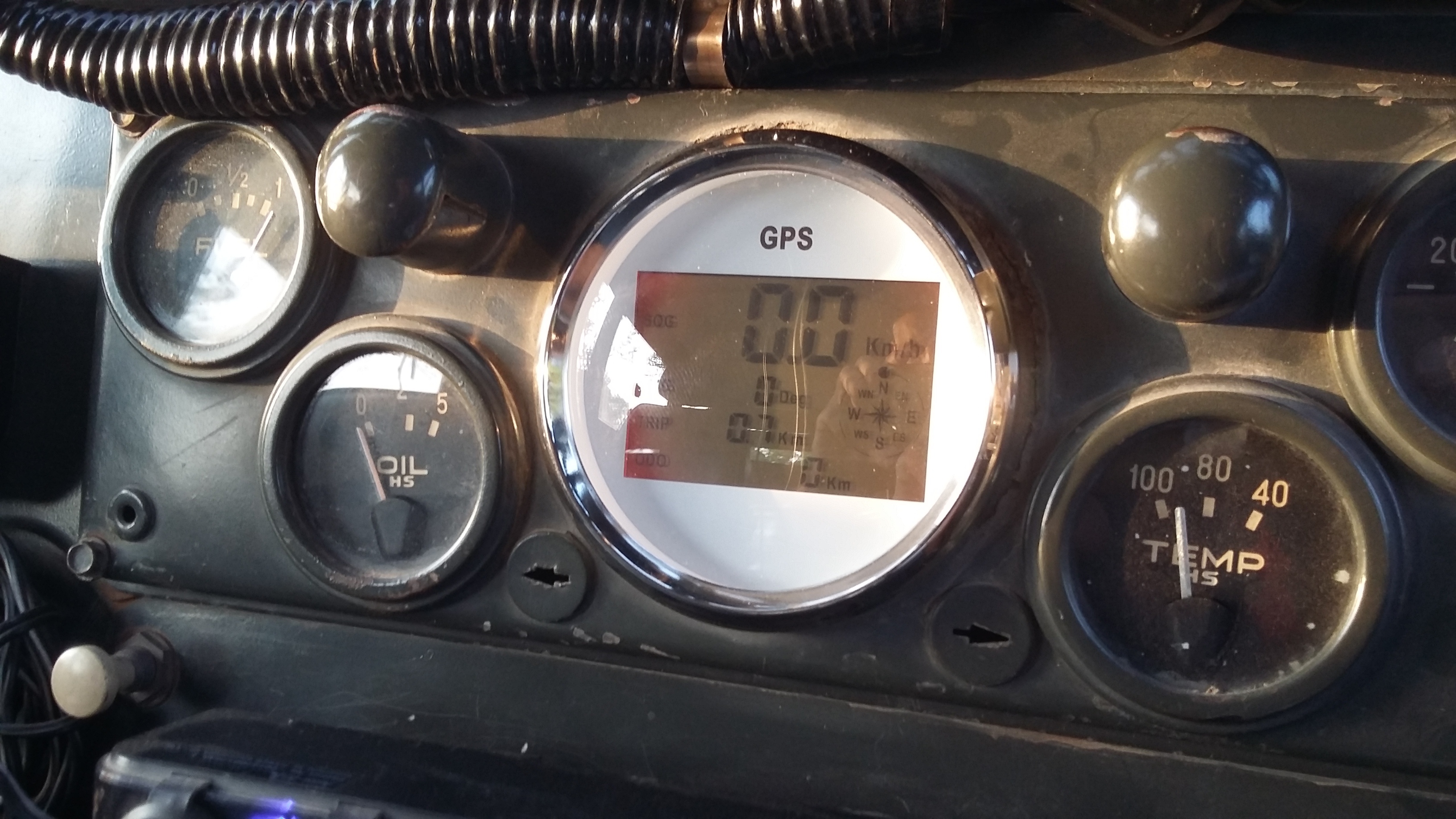

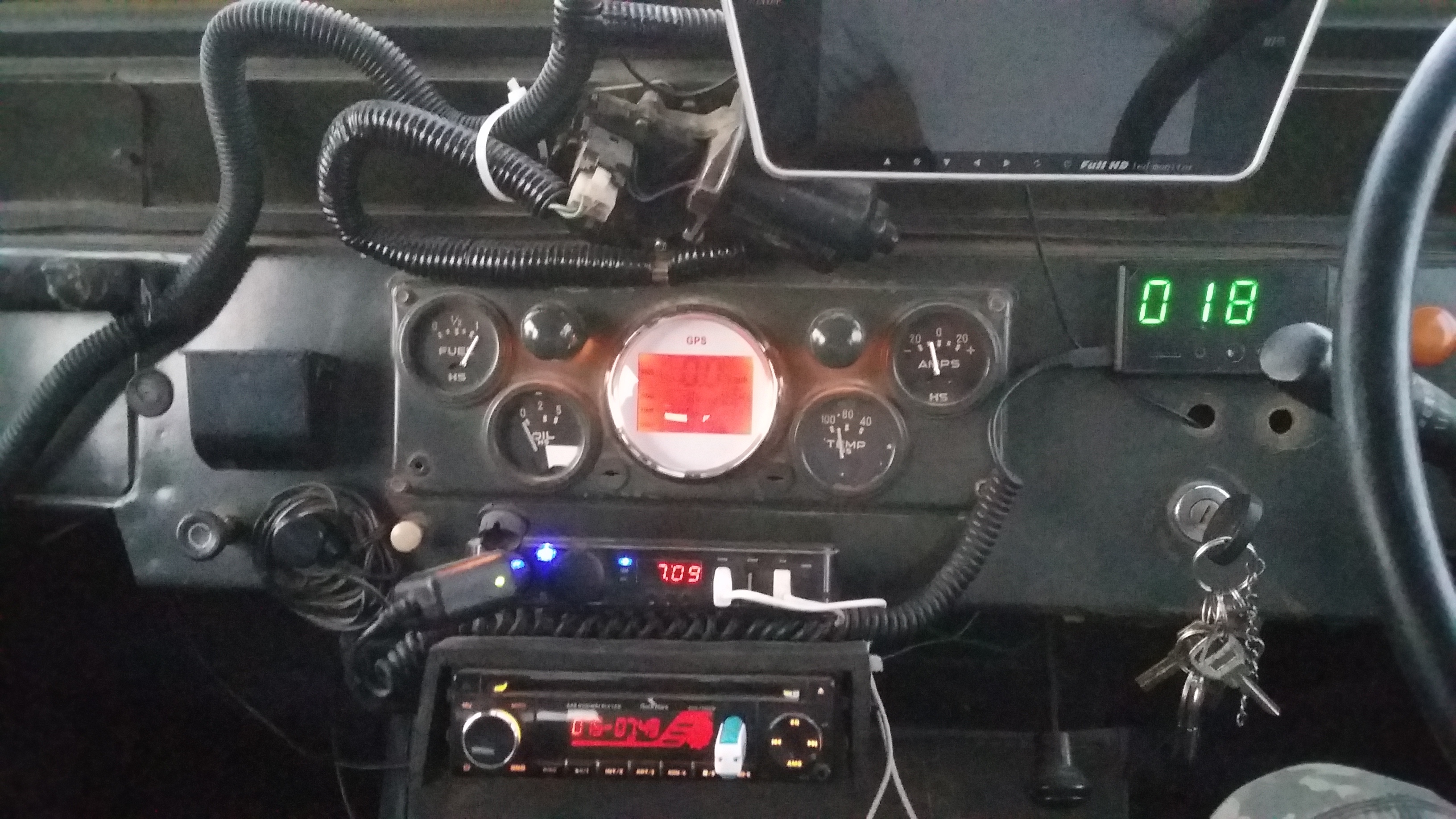

The new 82mm digital speedometer fixed with following readings.1. Speed check.2. Trip meter.3. Odo meter.4. EWNS direction showing.5. Degrees of direction.

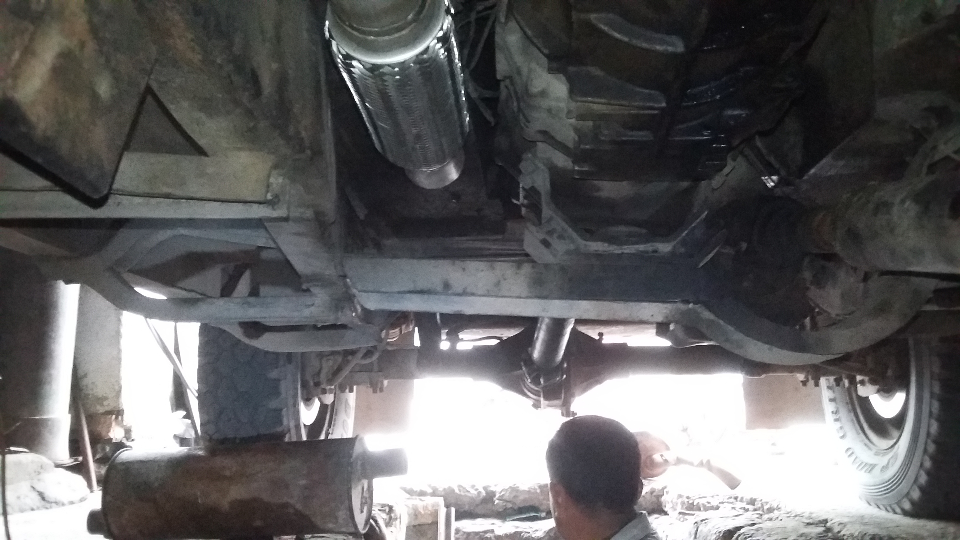

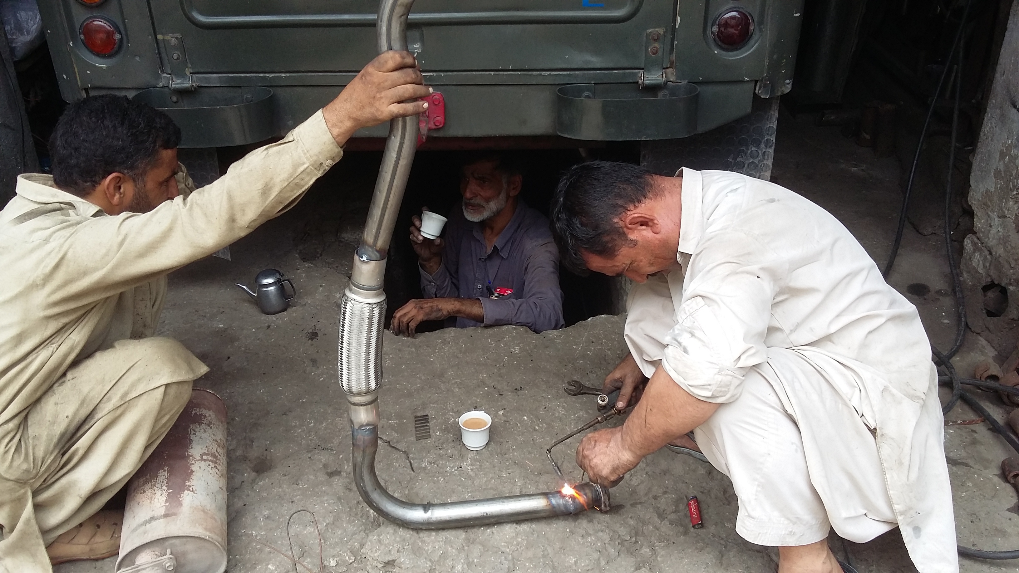

A new modified cylincer fixed starting from the exhaust manifold till the end. Jaali along with the dholki.

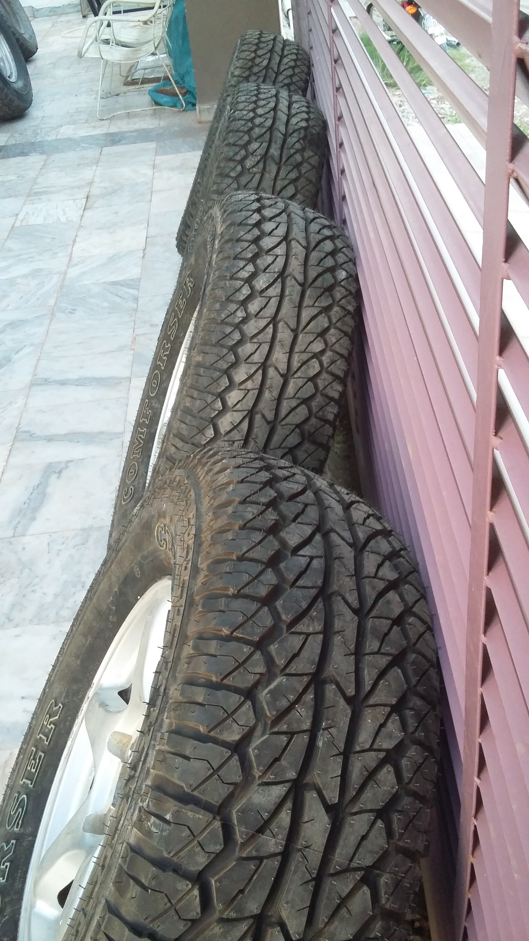

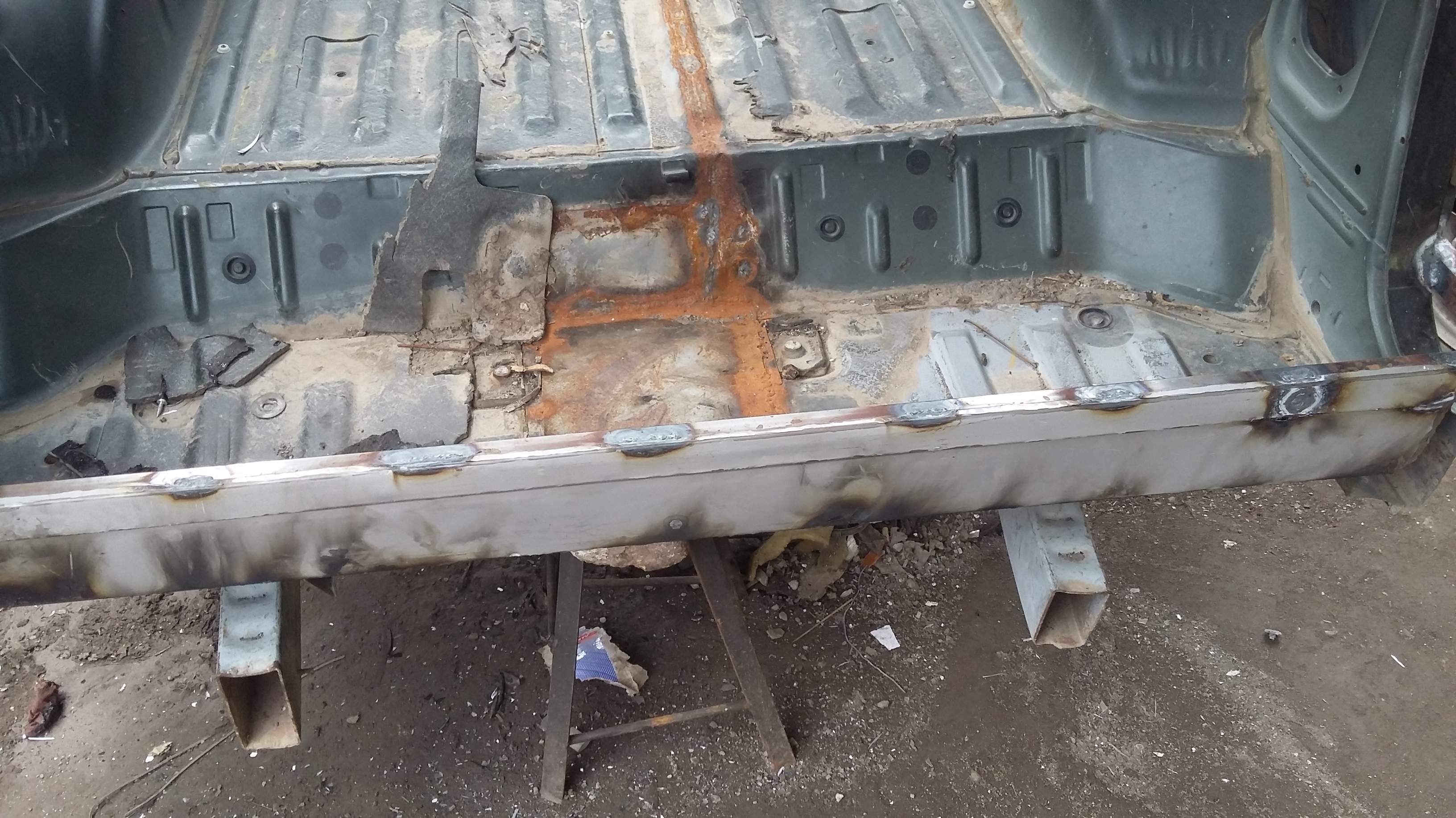

New tyre/ rims purchased.

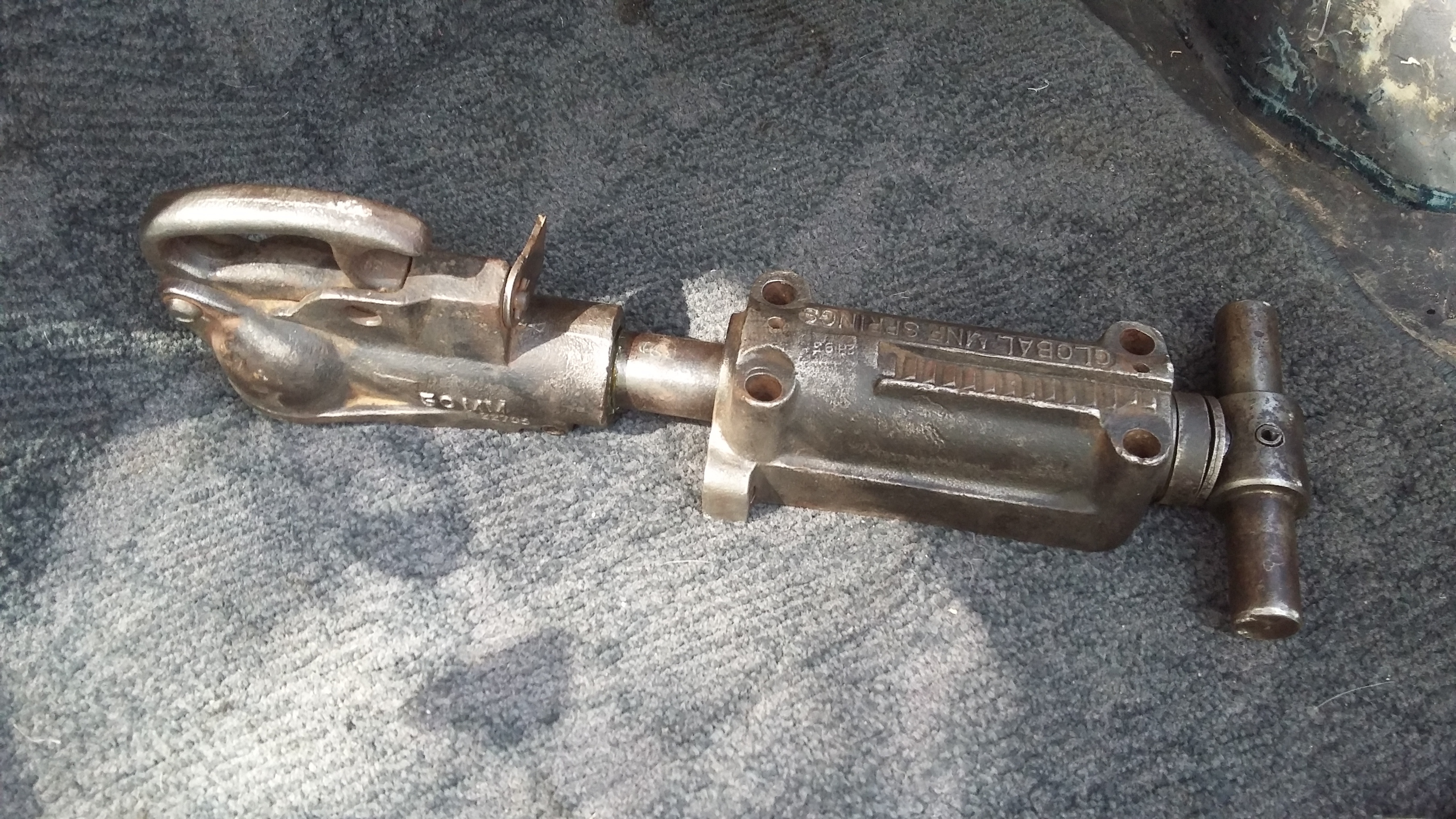

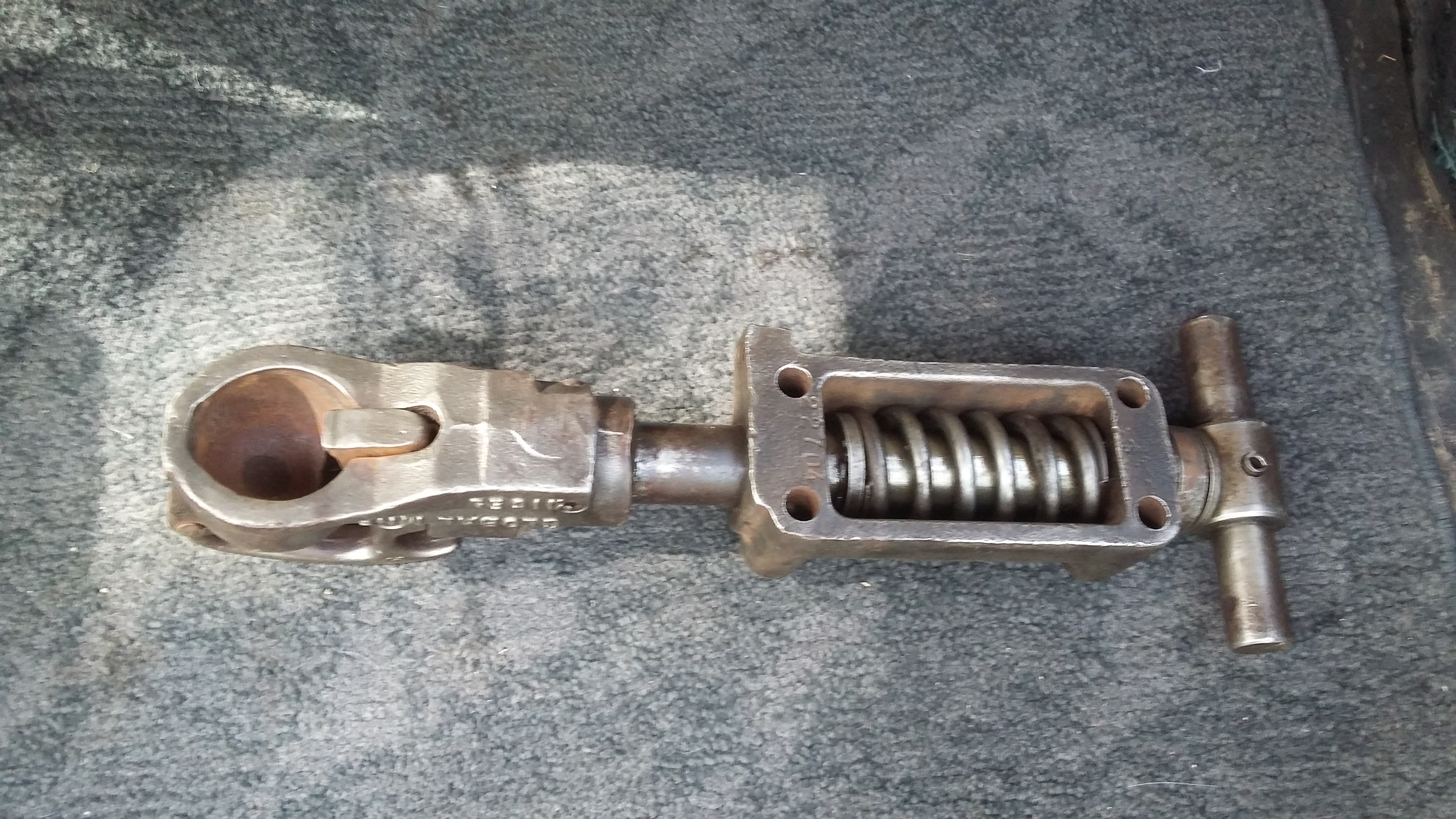

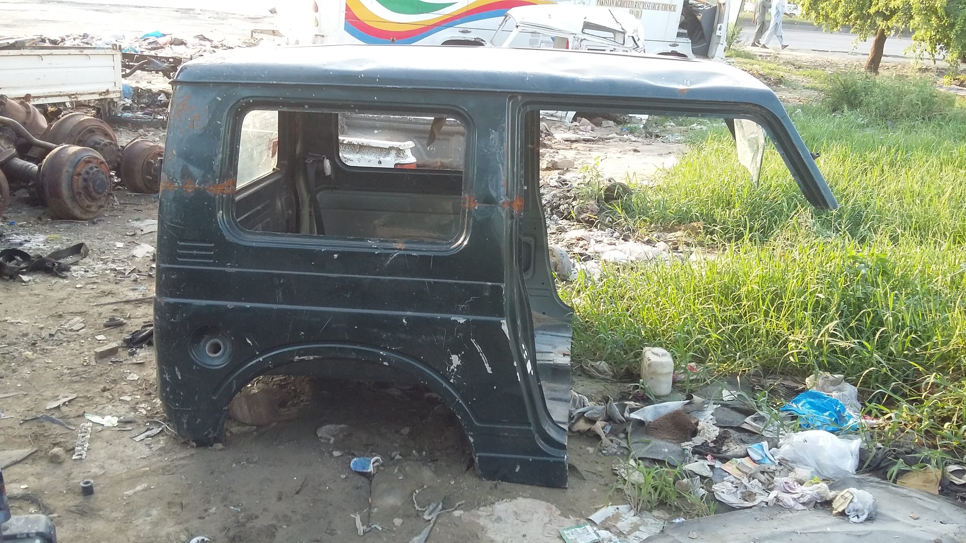

Got hold of the main part today. I have very rarely seen one with a spring. It surely will avoid jerks while travelling.
