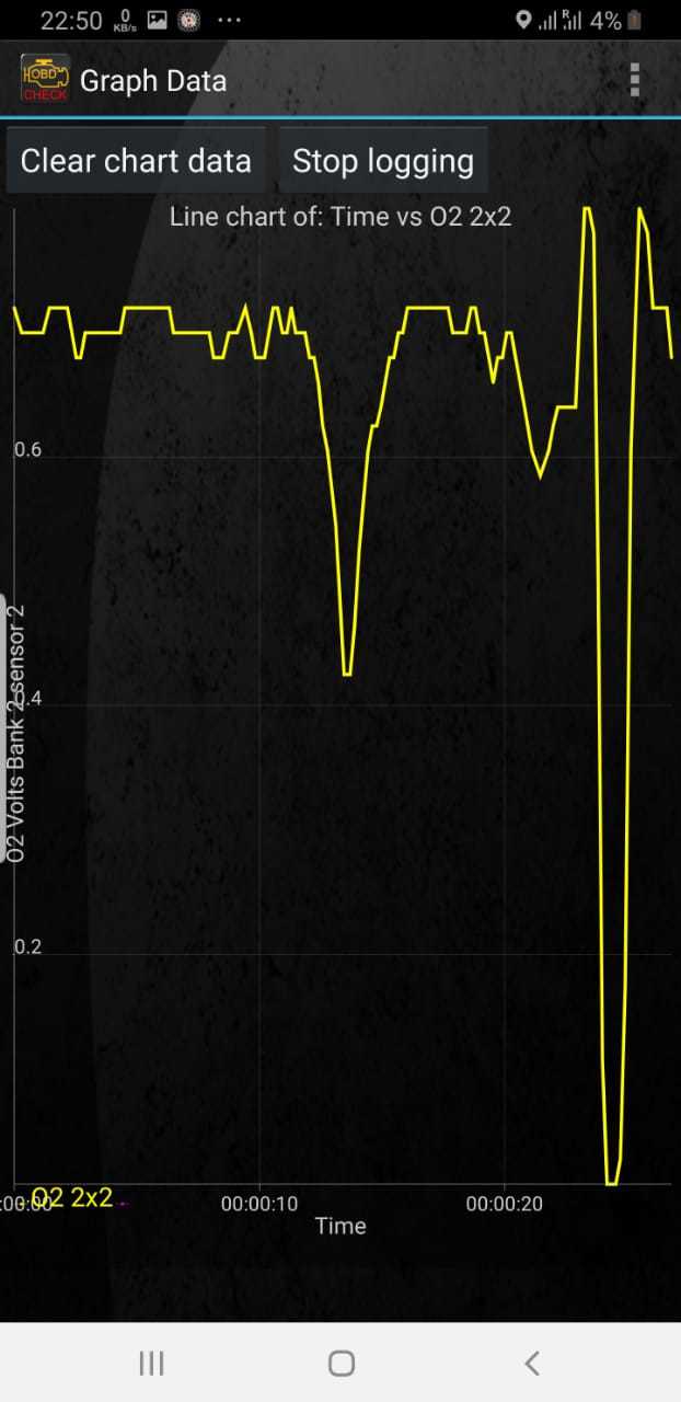

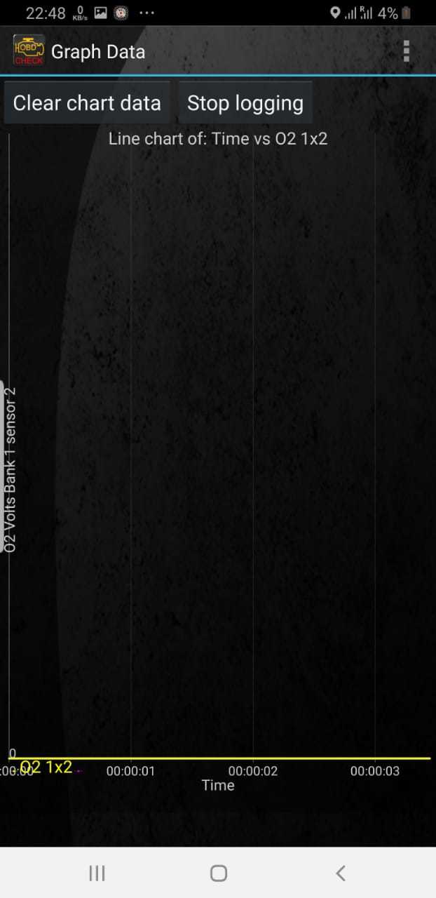

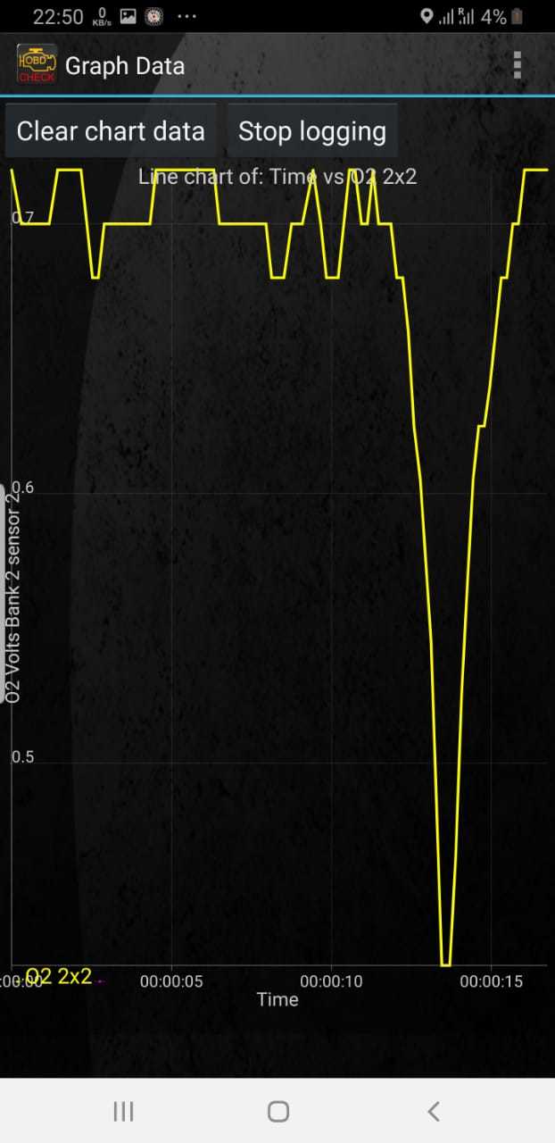

Another idea comes in my mind that last night the forum was saying MAF and O2 sensors are bad so why not get them too,
Went to toyota parts dealer and got 02 front Sensors for Rs30.000, got MAF for Rs 3000, and was unable to find 02 back sensors,
Came back and mechanic started installing FAN belt and he was unable to do so, he opened 02 pullys of supercharger to install the belt was unsuccessful, fixed the pullys back and through tensioner and Desi tarika got successful to install the belt,
Also installed new 02 front sensors, MAF sensor
Start the truck and there was no pick at 2000RPM, clear sign that supercharger is not opening as it used to work on 2000 RPM, very low pick
Mechanic said belt is okay now but i don't know any thing about supercharger,
Came back home at turtle’s speed to not hurt engine, and will go to Supercharger specialist who earlier worked on it to get it back to life,

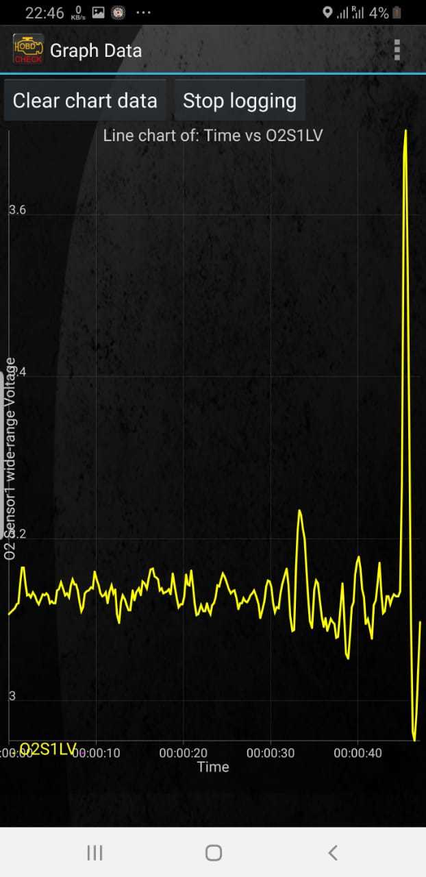

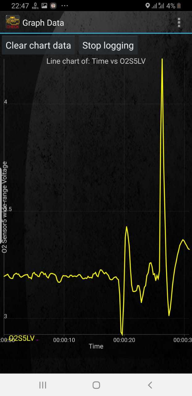

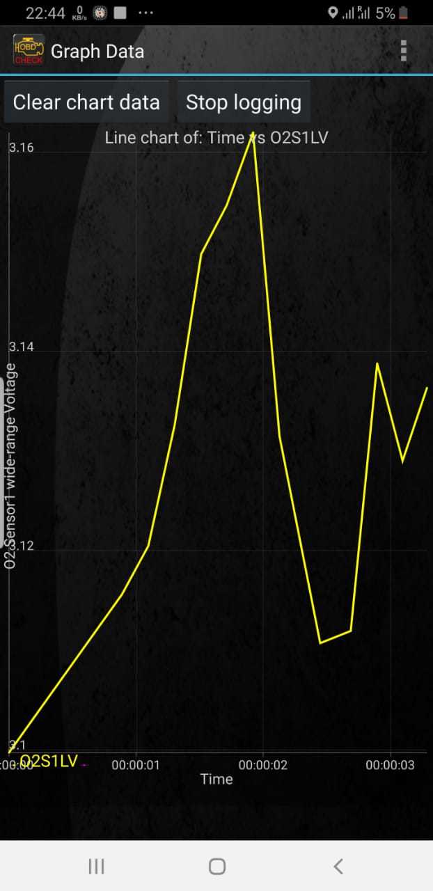

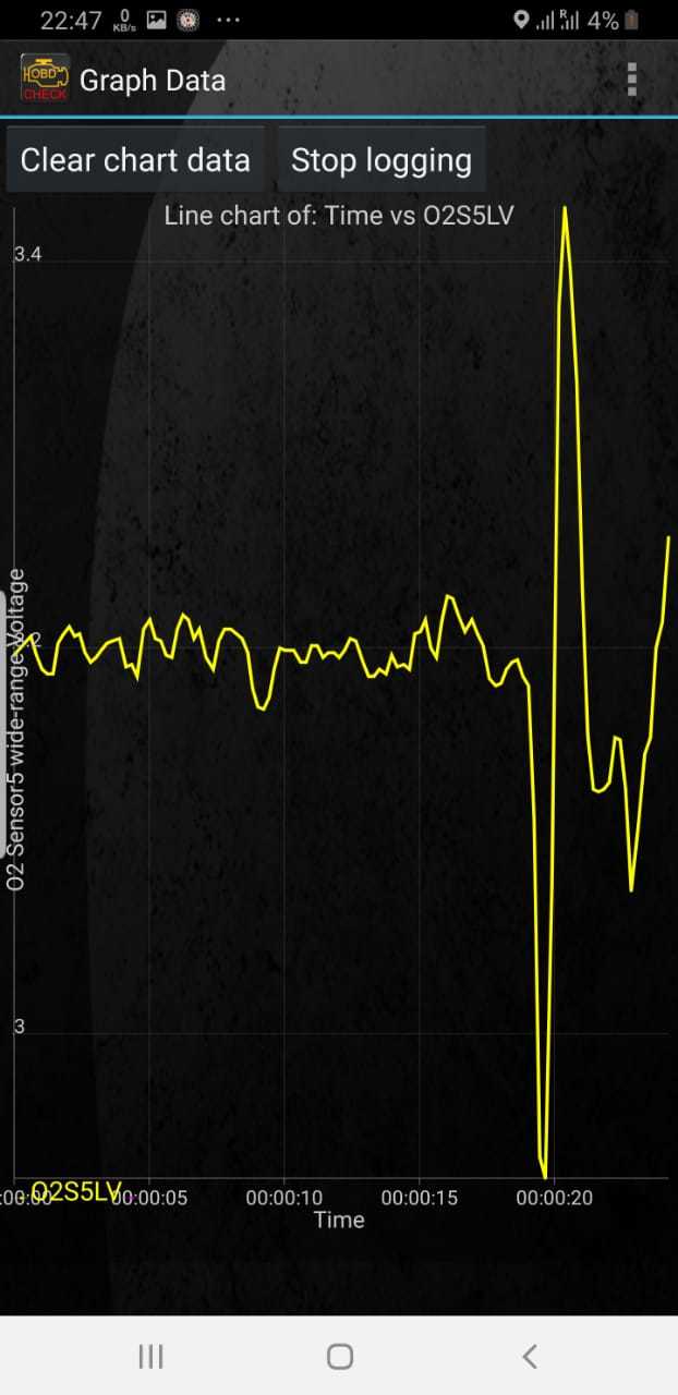

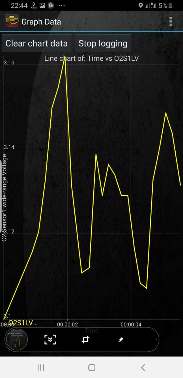

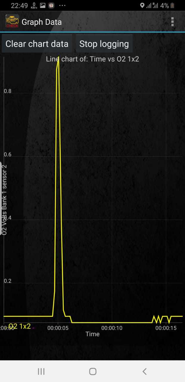

Surprisingly, Check engine light after erasing from scanner again comes up and again with the same lean codes
