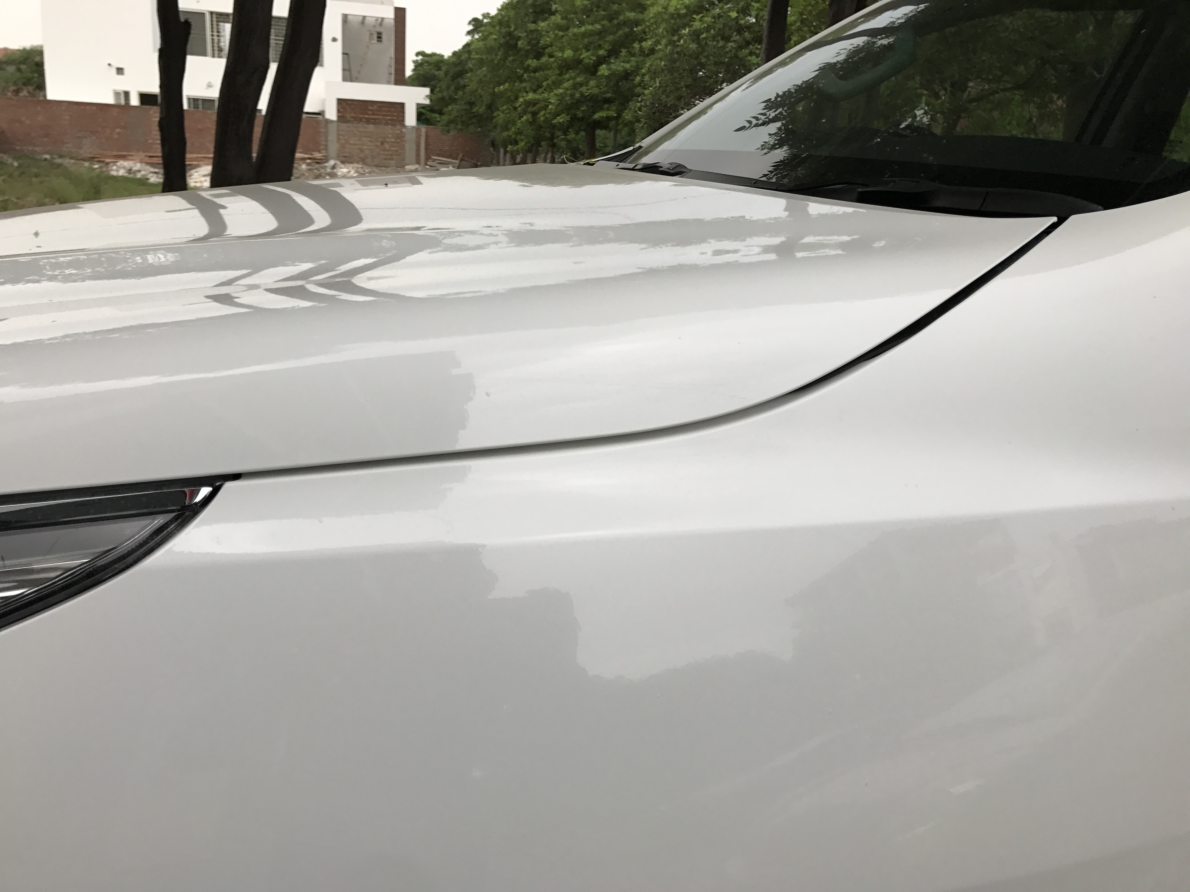

12-The wonderful Orange Peel and dullness in paint finish.

14-The hood gap/groove as it bends upward
