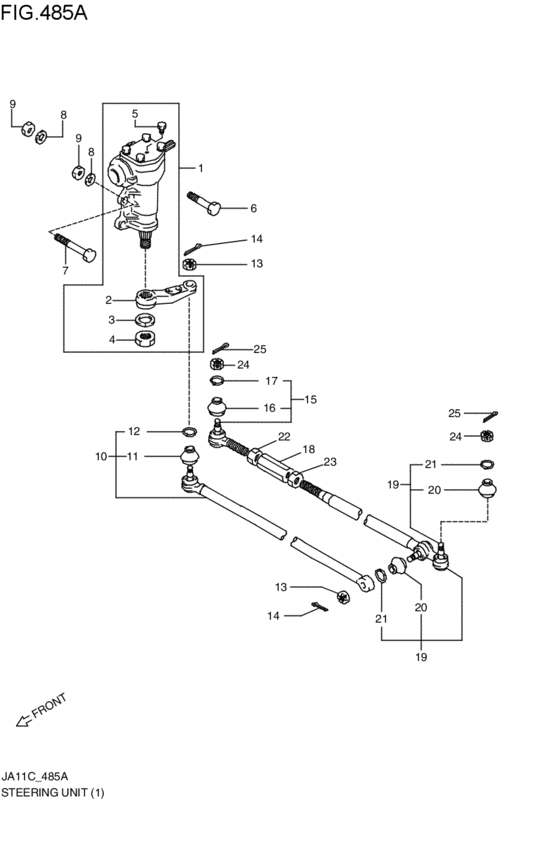

I'm assuming you mean the steering?
I don't recall seeing any zerk fittings on them, but I don't know. Is that what I should look for? I'll have a closer look.
