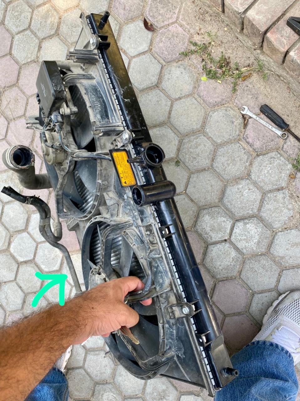

Let's start with an extract from the Factory Service Manual and the marking of the oil return line on the radiator.
There are some important points to note here regarding the process outlined in the FSM:
The process is outlined for a car with an ATF warmer/cooler whereas the lancers sold here cool transmission fluid by running it through the bottom of the radiator. Therefore, we will tailor the process as per our cars.
Instead of the ATF warmer/cooler line, we will be using the return line from the radiator.

Remove the oil return line (marked on the radiator in the image above) from the radiator end and attach a clear hose angled downward into a catch can (any container which can preferably measure the quantity too). I used an empty nestle 5.0 L water bottle for this purpose. (You will see 8 ribs on the bottle. Each represents 0.5 L and amount to 4.0 L in total. The 5th litre fills up the conical area above the top most rib up to the cap.) I also had an empty 1.0 L coolant bottle with 1.0 L capacity and 0.1 L (100 ml) markings.
