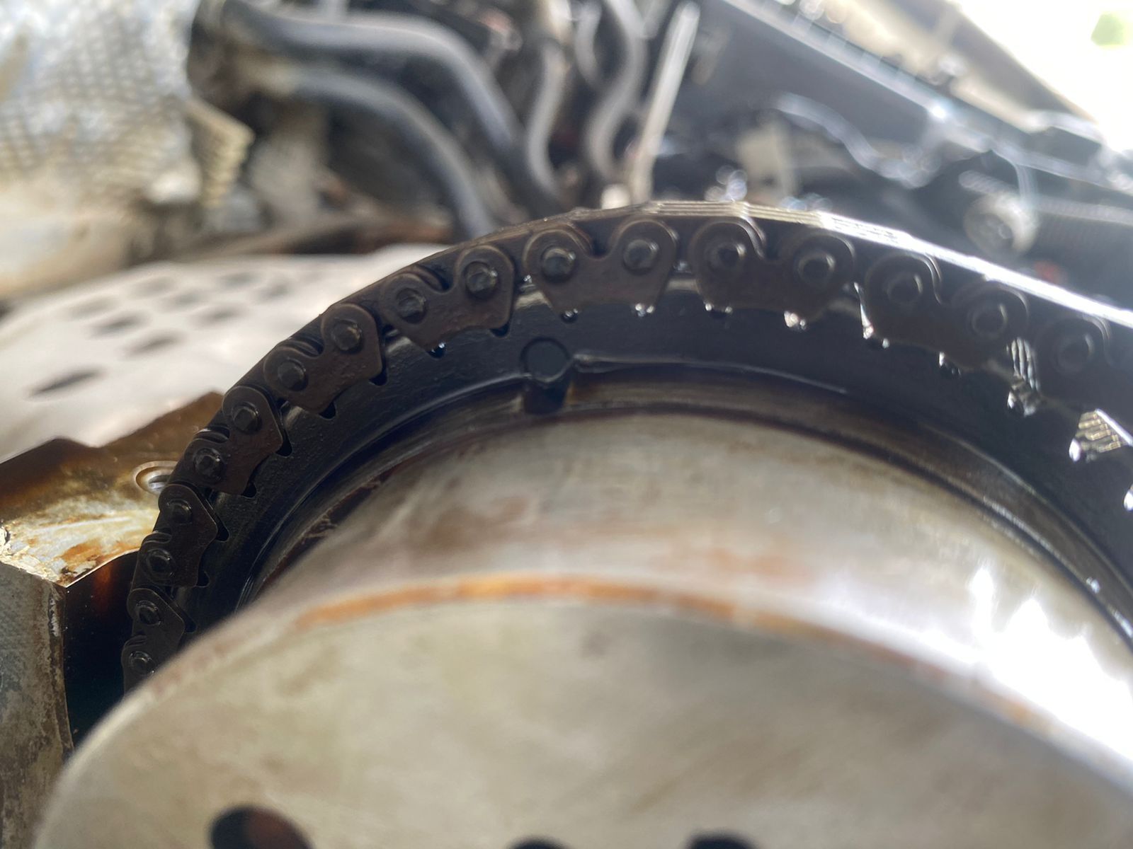

A bad chain when reinstalled can cause a jump half a link as you will assume the chain is sitting wrong, while infact the chain is worn out and as its a silent style chain its links seem to miss a tooth, while they dont, the space between the links is also the same shape as the space in a link.
Was the chain tensioner checked by removing the ratcheting pawl? it wears out and the teeth tend to slip.
